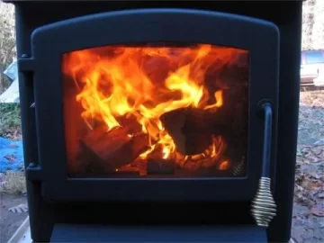

You'll find that a magnetic model on the upper arch of the front door gives halfway decent figures, it's the only real exposed portion of the firebox you can attach a thermometer to. As for break in fires, I followed the directions to a T :) and didn't see or smell a thing like others have stated, about 2 weeks ago, I loaded up the box and left the door semi hooked and the damper wide open for the char effect that helps me start a good secondary burn, went out side for what I thought was about 5 minutes, turned out to be a half hour and when I walked in it was OH OH time, temps on the mag gauge were above 700 and we definately had some paint curing action going on, I shut the door and dampered her down and temps went to 500 or so in about 15 minutes. Man did it stink for cured paint!! Took 2 days to get it outta the air.. I let the fire go out and did a very careful visual inspection and found no harm to be done but I was really worried about over firing and the damage I might have caused. (would of looked bad also as I'm on the local FD as well !!) Fired it back up and no problems and still running good!! I'm heating 2000 sqft+ so your gonna roast if you have halfway decent insulation!!

You will know as flames will gently come outta the top burn tubes and roll slowly across the front glass going to the bottom in all kinds of wierd shapes and colors..

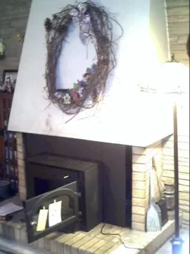

Interesting..your a fireman?..How close is that "stick thing" to the top of your stove? Unless thats kindling your waiting to burn? :ahhh: ...yikes

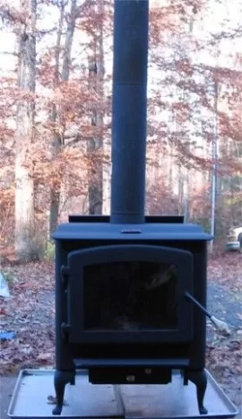

Doesn't smell bad at all if you light'em off in the front yard before you bring'em in the house.

I just did a new stove and did not think the smell was all that bad. Certainly nothing like burning the paint off a new barrel stove. :)
Andre, thats exactly what mine smelt like when it got around 700 degree's!! Otherwise I don't honestly think it ever got cured with the smaller fires, maybe being a steel box vice cast has something to do with it???? Fist- that vine wreath lookin thing was my wifes decorations for the past summer, rest assured it was removed shortly after the stove was installed, infact the hood is now a cranberry color and looks pretty good! BIS-yes the uniform of the day around here is definately underwear as anything else is just too much!! lol
T
If it's now a cranberry color, I'm really glad you removed it - hasn't anyone warned you about the hazards of over-firing? :-P
