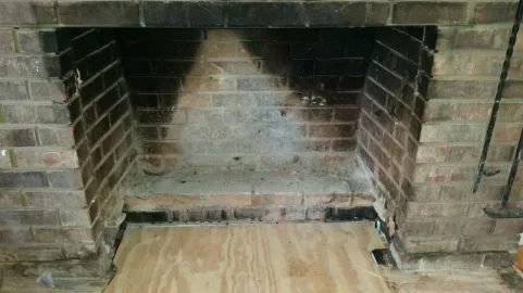

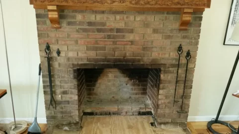

sorry for all the confusion. i don't think we'll end up with a zero-clearance fireplace. our fireplace is a very traditional brick and mortar fireplace and chimney. the fireplace box dimensions are 40"Wx28"Hx18D. its on the ground floor, and the chimney top is at about 33' above the hearth. ita a two story house, with very steep pitched roofs, adding to the chimney height. our chimney guys, who will be rebuilding the hearth, wanted an 8" flue on the insert. having seen that there are few of those, i plan to have another discussion with them about appropriate flue dimensions. i think they have in their mind we're wanting a stove, of which there seem to be a lot of larger flue diameter ports. i'll try and get some images together (on top of ice storm, fire, repairs i'm two weeks into a knee replacement as well, adding to the enjoyment of the experience :-)
--- michael

Weird. A tall, insulated liner has usually the potential to give you too much draft, not the opposite. FWIW, I would determine from your heating needs which size insert you will need. Then check what fits in your fireplace and go from there. Height and width of your fireplace are ok, depth can be challenging, especially if you want a flush mount. Is that piece of plywood going to stay there? If you finish that up on the floor level with tile or similar you could potentially put a freestanding stove in there. From where did you measure the height?
the plan is to rebuild the fireplace box as it was. i think we will modernize the outward look a bit (our house has been moving from a traditional look to a more contemporary look,

Sorry I meant the fireplace opening, not the chimney. Was the height measured from the brick in the back (which I assume was the height before the fire) or the plywood in the front?
indeed, this is quite true. we have not committed to any construction yet. we are not looking to heat our house from the insert, only wanting to be able to recover some of the heat. i love having a fire, but the house fire has put a bit of caution into me and i feel that a new insert and liner will help alleviate my safety concerns.
yes, the height was measured from top of where the hearth was :) the chimney guy says he can install something with a 24" height and have room to make all the connections.
