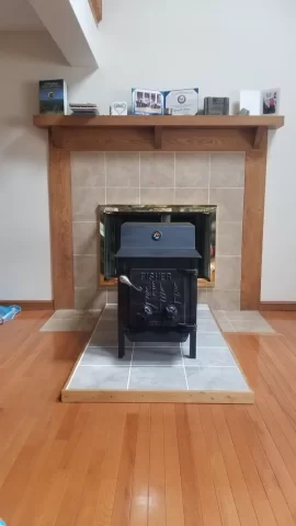

Hello I am currently looking for a new stove with a 6in rear exit. I am currently running a Fisher Papa Bear stove that was my first stove in the house last season. I was pretty satisfied with it and was able to cut my heating bill in half last year. However with the amount of wood it consumes I have started to look at something that will be a bit more efficient. My house is about 3700 square ft and I am looking for something with a little more heating capacity. The stove is located in a living room that is open to the second floor above, so heat transfers very easily where the location is. Any recommendations for the highest heating capacity stove I can find with a 6in rear flue?
Thank you in advance! Also attached a picture of my current setup.
[Hearth.com] New wood stove 6in flu

Can you add more pictures of how the flue piping and connector works? That looks like a fireplace that was converted to stove duty. What piping did you use? Did you replace an original double wall flue with the insulated 6"? Or line existing with insulated 6"?
