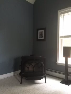

Hi All, just picked up a used Jotul F500 oslo and I'm begining the process of figuring out what I want to do as far as a hearth. I have a couple of challenges and hoping you guys can help. I'm installing the stove in the corner of the room. From corner of stove to wall it's currently sitting 14" away from the non protected wall. I would like to not protect the wall and simply install a hearth pad. I've been looking at woodlanddirect and found some nice corner pads there. I also have an issue with my baseboard heater. I'm not sure if I should have a plumber shorten this or not. What I'm thinking is simply cut out the carpet and place the hearth pad on the subfloor, then tie the carpet back up against the pad. Would this be adequate for floor protection? After reading my manual I think I'm covered as far as wall protection goes as I'm far enough away from the corner wall. I'm including a pic of what I have now. I've simply placed the stove in the corner on the carpet. Thoughts on baseboard heater? Floor protection? Thank you all, looking forward to getting this done and having my first burn. Chris

Clearance to combustibles. Whether wall or floor. If your pad meets the R value required by the stove (without looking, I believe yours is simply ember protection) and as long as you follow the numbers in your manual for wall spacing, you are golden. As for cutting the carpet and dropping the pad on the sub floor, that is exactly the way mine was installed.
Your manual will SPECIFICALLY state the C to C numbers required. Its okay to exceed those, but they are considered the "minimum" required.
Thanks Jags appreciate the response. Was thinking of maybe I needed to put a cement board in between subfloor and hearth pad but may not be necessary. Manual says must be UL 1618 ember protection so I must be good just to put hearth pad on subfloor as you mentioned. Just need to decide on the baseboard heater. I'll loose about 5' out of 22' on the baseboard heater if I shorten it. Since my stove will be used more as a supplement heat source I don't want to have to crank up my boiler just to heat the room when not using the stove. Will talk to plumber about that tomorrow.
I would consult the pro on the baseboard unit. Being that it is most likely a pressurized system I really don't know what the stove can/can't do to the system. My concern (if there is one) would be what effect will the stove heat have on the baseboard and system pressure.

Do you have the required clearance to use the side door if so you are ok but if it is 14" you dont have enough and cant use it
Jotul manual specifically states that in a corner install the side door needs to be locked closed. Also states that when in use 36" clearance to combustibles is needed.
Might get messy when that ember jumps out and drops between that new hearth pad and the wall out of sight....
The companies want to sell stoves, they keep these clearances to a minimum in hopes of accommodating more potential customers, they're minimums...
It would suck to have a fire, it'd suck even more to have the insurance company not pay out due to non compliant install.
I understand it's technically not supposed to be used, but I will have plenty of clearance and I plan on using it. Thank you
I think if you look around begreens advice and comments on previous threads, although perhaps not what you want to hear, there is good advice to be taken...that is why you are here.
One of the mods on here said something along the lines of "You are inviting fire into your home, be safe about it" it stuck with me and makes a lot of sense.

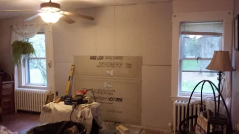

Also I am in process of redoing the hearth on our Oslo right now so those clearances are fresh in my head. I can attest that embers will leap from that side door and can create a stressful night if there's places for them to hide, as there was before I got my now wife to start her hearth modifications.
The new one in process...
