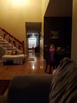

Veiw from that same chair downstairs through the house into family room..

Im leaning towards the red location.. this is where we spend most of our time .the other room well as you can see its just where the Christmas tree goes lol. i think it is open enough that the heat will flow out into the kitchen and through the hall way and fill the blue room not heating up the stove room to bad..
