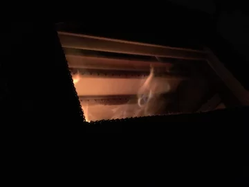

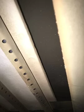

What I am not getting is the upper firebox being hot enough to glow the tubes but no secondaries. Is the baffle in that stove brick, metal, or fiber board? Maybe take a picture from the lower front looking up at the tubes and baffle.

I believe the us stoves us a single fiber board that simply rests on the burn tubes as the baffle, the board should be pushed as far back in the stove as possible, leaving a 4" gap in the front, also if looking at the tubes make sure the air holes in the tubes are facing forward at a slight down pitch

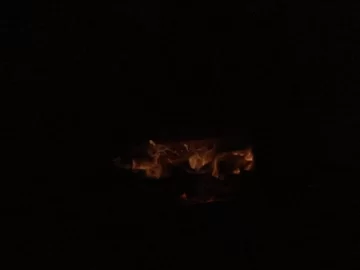

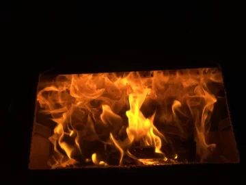

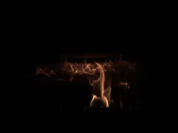

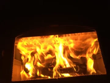

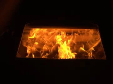

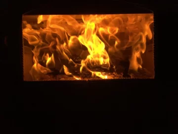

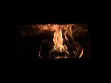

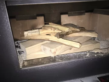

I tried the 2x4.. didnt work out well at all. Added some big chunks of kindling and then 2 more pieces of 2x4. Same effect. Ill add some videos and pictures. Temps never exceeded 400 degrees with the 2x4.
I hope I didnt over do it. You can see where the air control was fully open and then closed.

The look you have in the last videos looks pretty good. Mine would not be producing smoke with a look like that and with a larger load of dry wood, would build plenty of heat. If there is a setting between the partial and closed, then you may be able to build heat a little faster without a total inferno. For mine, once the load it burning, half open may as well be wide open. Once the draft is driving it, very fine adjustments between 1/4 and all the way closed it where it is for me depending on the weather.
You have secondary's going, sometimes depending on draft, fuel, burn rate you'll have that or a full fledge burn (like a gas stove out of those burn tubes) You will also find that the entire burn is better once you get about an inch of ash build on the bottom of the stove. I would say all is good, and once you get a stove thermometer, chimney pipe thermometer and moisture meter you'll be one of us (a wood burning freak)

All those burns look good,but i noticed you dont have much wood in the stove. Also you will not get secondaries anymore after the wood has out gassed
about halfway or more through the burn cycle. This stove is hard to pack full of wood while its running so i try to get as much in before i light it as i can. Thats always one of the drawbacks of a small stove.
Agreed. Partial looks fine. All the way closed looks great too. If you want the stove hotter it's going to need more fuel. That's a small load. There is room for at least 2-3 times that amount of wood.
Oh yeah I know. I usually fill it up by top of bricks but wasn't sure with the 2x4.
So when the wood is gassed out and no secondaries it's safe to smolder and have flue temp drop below 300?
Even when you have secondary flame you should be able to run on the lowest air setting and burn clean. Its just when you add wood and startup that you run wide open for a certain amount of time. I tend to increase the air as i get into the coaling stage to burn down those coals enough for a reload.
