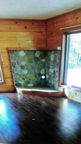

The thimble goes straight outside. There is a a couple feet of stone in each direction. I really wanted to avoid doing a pellet stove. Any specific manufacturers/models that may work? I attached a pic of the current setup.

Given the proximity of the thimble to the corner I am wondering if this is a legit setup. 6" stove pipe has a min. 6" clearance requirement. The stone does not reduce clearances. The question comes up then at how close is the edge of the hole to the adjacent wall?
On the chance that the construction is ok, then one solution might be to remove the hearth and rebuild it at floor level. That would gain some on the flue exit height.
