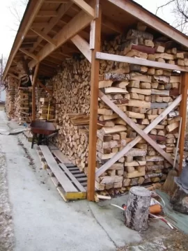

Great idea, so good I have been doing this for more than 20 years. Goal is handling or re-handling wood as little as possible. Keep at it.

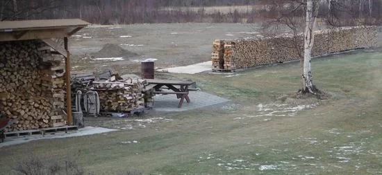

I have built a similar wood rack. It's not the best pic, but you should be able to see it in the background.

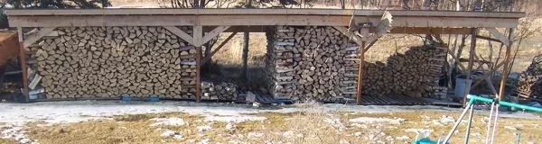

Did mine with similar idea. (wood port)
3 each, 16' sections, (48' long wood shed)
8' wide so I get 5 rows of 17" splits
Each section is a years supply (6+ cord each section)
I expanded the idea. Now have 1 year of outside seasoned wood ready to go & fill the section emptied thru burn season.
1 year outside & 2 years in the shed. Almost got ahead enough to have all sections full come Aug 2013.

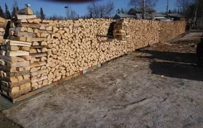

Needing 5-1/2 to 7 cords per year depending n the winter & be 2 years ahead, a 4' wide shed for me would be several hundred feet long.
The 4-1/2 feet tall X 70' long double rows is enough for just about 1 years burn season.
Would be nice to have a roof over the 70' double row seasoning stacks too ;)
Something like you are planning.
