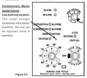

When the stove was installed was the low and high draft set correctly? Too high and your pumping heat out the back.
They can be picked up up for 30 bucks everyone should have one.
Thanks HarmanMan, I'm new to pellet stoves - can you please explain "the low & high draft set correctly" on installation? My dealer told me all I needed to do was do a 2' horizontal vent out the back and plug the unit in.
I'll let HarmanMan explain but when I installed my P61, Harman frowned on just a horizontal vent. Saying it's their least favored venting method, much prefer some vertical. You are good on the 2 ft part but by the install instructions you will see their preferred methods vs least preferred. And they really don't like a longer horizontal run. I kept mine to 1 ft then went up 25 ft in the end ( fireplace install with 4" vent).

Here is a link to the manual if you dont have it. Look at page 17 and follow the instructions. I have the same venting as you and my draft was so high from the factory i had to turn the control all the way to the lowest setting to get it to where it should be!
I have a feeling you High Draft is going to be a lot higher then the 0.5-0.6 WC that the manual calls for. Mine was over 1.0 when i installed.

HarmanManp43, when using that meter with a pellet stove do you do it with the stove running ? And where do you get access into the vent , is that a drill a hole and plug it when done proposition?
My P43 has a 12mm Bolt on the side of the stove for this purpose XXV i assume has the same. The manual does a better job explaining it then i do but you put it in test mode and then record the high draft. Then after 1 min the stove cylces down wait 15 seconds and record the low draft.
Sorry just re read your post. I havn't done an air velocity test on the venting as all i have is 2ft of vent. This is a static pressure test between the stove and the room air.
Cool, p61 is probably the same, I will look in my manual. Thanks !
Harmans have no combustion fan speed control.
Sure they do ...

I'm going to make generic statement of caution here. Unless you really know what you are doing, the average Harman owner shouldn't be messing with the draft adjustment mentioned here unless you happen to have a DDM (Harman's digital diagnostic meter) or access to one. Just sayin'.
Would you mind sharing what you know about Harman's draft adjustment?
When I asked my dealer during my self install, he said that they don't bother with that but yet, Harman
devotes a whole page on this topic.

What I know is this, Harman factory sets that adjustment at a perfect 120 volt power supply and draft. Every install probably drafts a little differently and not all current is 120v on the nose. So in moving that adjustment ya you change the factory setting from their perfect setup. And if you move it, you can always set back to that setting if your move was wrong. Just put a mark where it was set at before you turn the screw.
The manual is very clear as to what the draw should be in a given install. In many cases you may not need to adjust a thing anyway but you will never know that without first taking a meter reading.

Sure...what I know is what I said..."most" people shouldn't be messing with the low draft adjustment unless they know what they are doing. I'm sure there are folks here who are quite comfortable with using a draft meter and checking their low draft setting. To that I say go ahead...Harman sets the voltage right at 120V from the factory and in "most" cases, it won't need adjusting in the field. They devote a page to it in the installation manual not the operation manual. I'll grant you, most of us here that participate regularly are probably pretty pellet stove savvy as it relates to our own individual brand and level of expertise. I just don't want the occasional reader to grab a screwdriver and start messing with something that they shouldn't.
