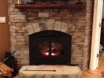

New ZC fireplace installed
MasonsDad
Nov 12, 2014
17
SouthWestern PA
Recently installed a north star ZC fireplace and wondering how do I read temperatures on it since it is so well insulated and no chimney access? Taking temperatures off of the metal frame on the glass door accurate for stove temps?

What temps do you get on the front door frame? Are you using the air cooled chimney? Do you have any pics of how full you load the firebox or the placement of your thermometer? Sorry for all the questions, but can't seem to find anyone that has this unit for advice.
That's a very handsome installation. It looks great!
If you want to go by instrumentation you will have to use a thermometer on the upper front face and come up with your own offsets for normal running temp.
Thank you. Turned out fairly well. I think I may be under firing this thing, but not confident in loading it full and blazing away without knowing if it's getting too hot. Getting some dirty glass and my chimney cap is dirty after only a couple weeks of use. Is it easy to over fire? The door frame is the only part that is not insulated and I can get peak readings of 650 with heat gun but it stays around 450deg.
