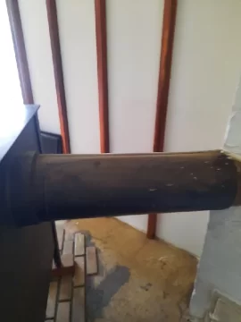

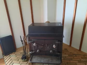

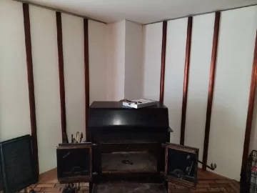

Recently bought a house with an older Glacier Bay wood stove. Had it inspected and cleaned and everything looked good with a level 2 inspection. I didn't even think to ask the tech about properly burning in this. I did look on the wiki but the manual for the stove doesn't match my style. There's only the two doors for the firebox. I'm assuming to keep the doors closed when burning for maximum heat output? How does this stove draw in air from the room (if thats even a thing?) I burned in it tonight for the first time and left the doors open. The previous owner had some grates that go over the opening when the doors were left open. I've attached some pictures of the stove for any insight. If the manual in the wiki that closely resembles this stove will suffice I apologize.

Air is supplied to the fire via the draft caps on the doors. The stove is basically a Fisher copy. You can use the Fisher manual for operation. Go to page 13.
Dry, fully seasoned firewood and kindling is what makes for a successful fire.
It’ll heat better with the doors closed. Too much air will pull the heat up the chimney.
Yup doors closed for sure. Get off to a good start and use the "Top Down" fire starting method.

Hi! I have the same stove in my home. Have you figured out what the knobs on the front of the stove work? I can't figure out how to close off the air supply when not in use. The smokey smell has drafted into my house days after a fire.
The knobs just dial in (clockwise) to close. If this is because of negative pressure in the area of the stove, closing off the air control may not help.
