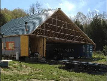

If you have a large DHW load add some solar panels to that building. -2F here today near Springfield and my solar DHW kicked on before 9:00!
Here is one of the buildings I had build to house a gasification boiler. I put glass on one side to turn it into a solar heated greenhouse and tool shed.
