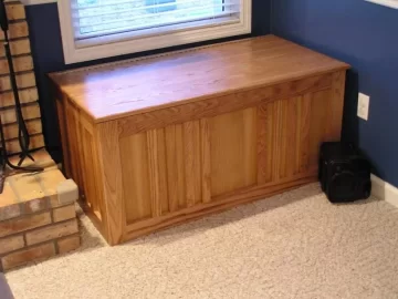

If not a simple door, I imagine some kind of bin/chest/box like this could be used?
(broken link removed)
Somehow have access from the garage and build a box in the family room (flush and finished to the wall) that holds the wood? Or simply have a bin in the garage and allow a reach through from the family room access door into the garage? Ideas welcome..
