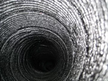

Yes, it is another topic about chimney cleaning ... but in the big picture I guess that is a good thing.
I checked out my chimney a few days back and have to definitely clean it during this week's warmth.
This my first season and have been burnt about a cord since mid-December. I have been burning a mix of hardwoods that have been split since spring and stacked and covered since mid-summer. I know some of the pieces are still wet from the sizzling sound but others burn very good and hot. I have been adding a bunch of softwood kindling to get the heat up and dry out the suspect pieces.

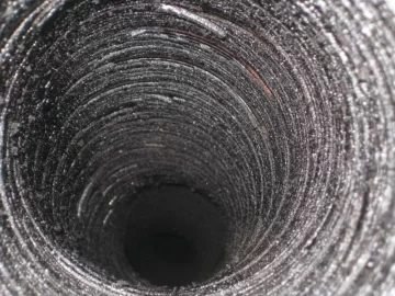

First ? ... Is that stage 2 creosote on top? Also, one picture shows the cap with some staining on it ... Is that a problem or is it normal?
Second ? ... How do others with inserts clean from the bottom-up?? Being my first time for cleaning, I would imagine a big dust cloud coming down at you ... how do bottom-up insert cleaners manage that mess? In this regard top-down cleaning seems simpler since you just close the door on the insert and brush away.

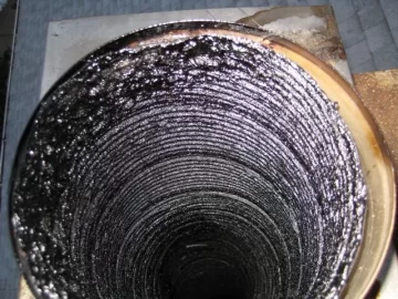

Another picture farther down the liner ...

The top part where it sticks up above the chimney will always look much worse than the rest. It cools there.
You can still see all the ridges there. Did you expect them to be silver and shine? Did you take the time to clean it?
It really doesn't look that bad to me but I would run a brush down it since I would have it with me up there anyway. IMHO defiantly not worth a trip up on the roof just to clean it.

I think a good scrubbing will take care of that, just wet wood in my book, and maybe not hot enough. Do you have a nice Rutland thermometer for the stovetop? Or a laser thermo? If not go grab one

All, Thanks for your input ... I didn't know exactly what to expect but I new the shiny black creosote (stage 2 or 3) was the bad stuff ... so I was getting a little concerned. It makes sense that that stuff would exist at the part extending past the chimney. Knowledge puts the mind at ease.
I just got my chimney brush last night so now I will be cleaning it asap.
