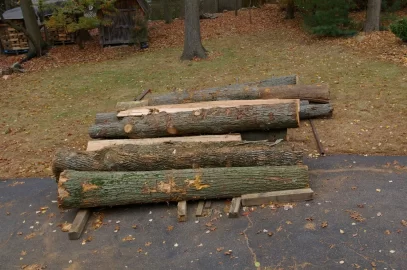

. The tree guys are not going to be dropping off the easy stuff for free. Its going to be the big, crotchy, poison ivy infested pieces that they don't want to process or sell themselves.
But you can can get the neat, clean, easy wood delivered for free here. Logs or rounds take your pick.
This was all in the past year. Yes there was a vine or two of poision ivy on one of the ash logs and ants are a a given. I get the wood when it is cold so they can be delt with.

I even got the most 'crotchety' logs put directly on the 6x's for cutting.

I've been thinking about getting a splitter for 7 years. I also keep thinking about renting a splitter to see how I would like it. I'm three years ahead of wood, and my yellow maul just keeps on making firewood. Hand splitting is truly great exercise. I'm in my 50's and I will keep thinking about getting that splitter as long as I can.
Just a half load here, about three cords. Same price as above.
This is the above log load + my neighbors oak tree which which bucked and rolled into my yard. About 3 cords of red oak in that.
Wow, nice looking stuff. Guess you won't even need to rent a splitter.
