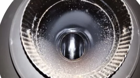

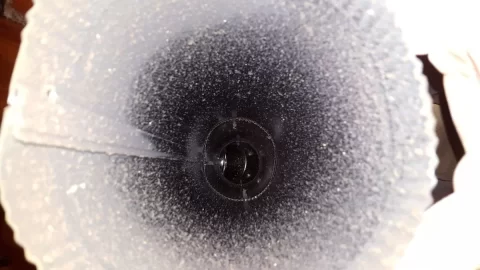

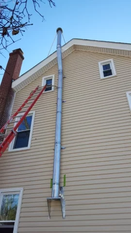

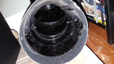

Well here we go, new house. Decided to finally install a wood burner. Stove is the Englander 17vl, single wall conector pipe to selkirk dubble wall ultimate one class a through the wall and up roughly 28'. I have been burning it about 3 weeks now, and decided to check my class a, and my single wall. Here are my findings. Keep in mind i am new to burning and i have had some smokey fires, i also found out that 70% of the supposed "seasoned" wood that i bought is over 20% moisture :mad:. . Does this look normal?

should i be concerned about the shiny creosote? Is it just from burning some wet wood fires? Or is it my conector pipe being single wall, not keeping my flue gas hot enough? Any help/ imput would be awsome. Thank you for taking the time to read my post.:ZZZ
Shiny = usually not good.
Creosote like that typically comes from not burning at the right temp (i.e. in the Goldilocks Zone -- not too cool which helps make the stuff and not too hot which can ignite it) and/or burning wet wood and/or choking down the fire too much.

The black shiny is from the wet wood, NOT the single wall pipe.

I'm also wondering if that very long run of external chimney might be cooling the smoke too quickly.
Check out woodheat.org and click on "all about chimneys," then click on "the evil outside chimney."
That shiny stuff is in the connector pipe. The wood is damp.

Just how long is the flue from floor to cap? Over 25-30 ft? Thirty feet seems to be the point that causes overdraft problems, but that can vary.
