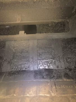

Thanks for the tips guys. Got it out....
Holy crap! There was 4” of creosote on top and around it.
Yup that is pretty common for slammers. The smokeshelf probably has a huge pile as well
Yeah. It’s a total mess. I’m going to tackle it tomorrow probably... The chimney itself surprisingly didn’t look terrible to me.
Bought this house from an old couple who obviously never pulled it. It’s a wonder the house is still standing.

Another question. How can they run a liner through this damper (not sure if that what it is)?
A slot gets cut out of the damper assembly so that the liner can pass through.
What is the ID of the tile liner in the chimney? It looks pretty small. 8x8?
I plan on cleaning the smoke shelf off as best I can, but can anyone tell me if I need to clean the flue and scrub down the fireplace if I’m just going to install a liner in it anyway???
Thanks
Thanks
Yes absolutely it needs cleaned really well.
