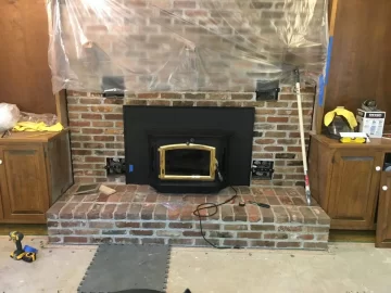

Thanks again for the input. Painted the stove yesterday and today. Now doing a burn in the driveway to cure the paint. If I knew how to post a picture- I would!
  • [Hearth.com] Newbie just bought a Buck 91
You did fine. Fire in the hole!
Looks great. Nice job there.
