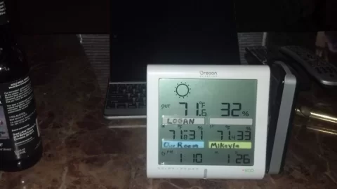

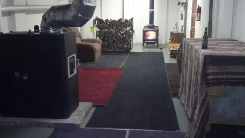

I have a Fahrenheit and Love it!! Keeps the temps even throughout the house :cool:
Harman PF-100 is the Cats Meow of Furnaces. Buy it and Never worry again. Just know your chit is the Best ;)
Here is a Pic of mine and the room temps of my 3 bedrooms (ours and the kids).
[Hearth.com] Newbie looking for advice [Hearth.com] Newbie looking for advice
Dexterday: Sweet set up. Are your bedrooms 1 or 2 levels about the furnace?

Thanks. Furnace is in the basement and only have one level above basement (Ranch).
Hey Dex. I noticed that there is a piece of wood out of place to the right of the Englander. You must have had an off day when you took the pic...or maybe it was the beverage of choice that day :)
SWEET set up there !
