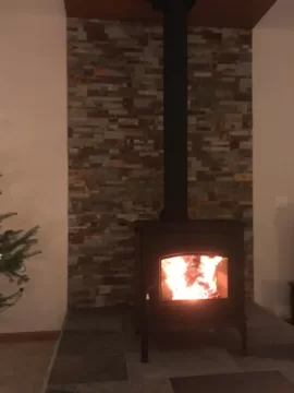

Hi everyone. Update on our f55 install! Here is a photo

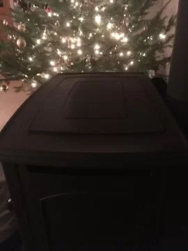

I have a question. We did the first burn tonight. Is the top supposed to look like this?
See the left side is glossy and right side (top) is dull after first burn. This doesn't seem right to me. Did we ruin something on the top of the stove?
Sorry if that's a stupid question.

Can you tell me if it's normal to have part of top shiny and part dull?
I posted photo above.
I would imagine that it is the paint "burning in" -- probably eventually all end up dull.
Check with your supplier and/or manufacturer if you are concerned.
Ok thank you for your opinion about that. I also asked on the f55 forum. Hoping other f55 owners will tell me if this happened on their stoves.
Did your stove start out shiny and then go dull like that after first burn?
Forget which stove you own....
