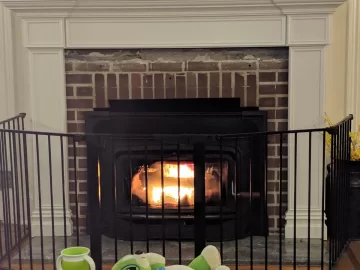

What type and size fireplace do you have
Here is a picture of the current fireplace and the dimensions.

Have the Ashford 25 here , not used to heat the whole house ( house is 4400 sq ft with the finished attic included) that said usually run it about half way open and get some nice heat headed up the stairs, keeping about half the house warm and decent burn times of about 8-10 hours with the fan on. As far as looks I don't think it can be beat

You have a good sized fireplace, the ashford would be a good choice and give you long burns while your away. You could also do a rear vent free stander too.
