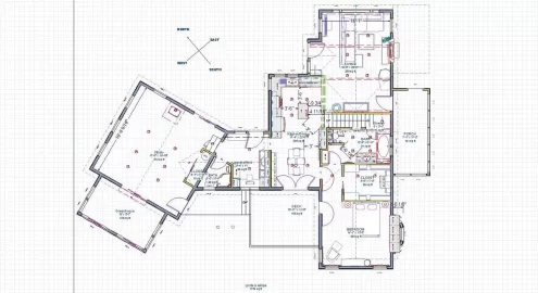

Thanks for the response and the welcome! We are remodeling and adding on. I'll attach the floor plan. We are making the bedroom bigger and connecting the garage to the house to make a laundry/mudroom and add a second bathroom. Hopefully we will also add a greenhouse to the back of the garage (hoping to produce the majority of our own food). We are debating having vaulted ceilings in the garage conversion and/or the living room. I know high ceilings aren't great for heat but there are other considerations. We decided early on for a fireplace in the living room because we love the ambiance of sitting around fire gazing. Currently the plan is to build out a "box" for the fireplace because the room is fairly narrow and we were trying to get our furniture in and meet clearances. I'm concerned whether the fireplace will be able to heat the main portion of the house, especially since we have to build out. We are considering whether we should connect the fireplace to ducting to get heat to the bedroom or possibly have a central duct system and connect to that. I think Napolean can do the latter. I didn't like the Napolean NZ6000 because it's EPA exempt and read on here it was a wood hog. The NZ3000 is EPA certified, but can't recall how it compares to the Northstar. Still not sure whether these can do the job or whether we could move heat from a larger wood stove in the garage. We did look at the Fireplace Extraordinaire, but didn't want a catalytic unit. Remodeling includes updating windows, insulation, electrical, plumbing and kitchen. The final plan is ~1637 sq ft downstairs including greenhouse (because we are intending the heat from the wood stove to keep that warm as well). Upstairs is a converted attic--room and closet ~225 sq ft. Thanks again!

The layout of your house is challenging. Heat distribution could be problem. If I understand you correctly, you are planning on putting one stove in the studio and another one/fireplace in the living room? If you are able to insulate your house well that should probably keep you warm. Did you ever try that pellet stove you mentioned and where is it located? A fireplace has the disadvantage that you pretty much require a blower to get the heat distributed. A stove with its radiant and convective heat will keep you warm even through power outages. Many stoves also allow to cook on their top if the need arises. The price difference is also substantial. Many modern stoves have a large viewing area still allowing you to gaze at the flames. Here is an example: (broken link removed to http://www.osburn-mfg.com/en/heaters/model-OB02211-description) . The Osburn 2200 is a medium sized stove with a 2.2. cu ft. firebox which should be plenty if you also get another one for the studio. There are certainly other options. Be aware that "boxing" out the fireplace will cost you in efficiency as several sides will be exposed to the outside. Another point to keep in mind; you are pretty high up. Make sure your chimney will be tall enough to allow good draft. Otherwise you will be very disappointed with your new stove.

Grisu, the pellet stove is in a built-out alcove on the kitchen side of the living room. In the plan I posted, it is where we have the front door. I was clear I wanted to have at least one wood stove because of what you all mention--power outages and cooking (power goes out a lot but not for long and in an emergency we can live in the studio). I sort of fell in love with the fireplace look in our plan renderings and our architect seemed sure it would be functional. If I had gotten on this forum a year ago, I might have given up on the fireplace, but I would have come up with a different layout. Getting the house warm and getting heating costs down was at the top of our remodel priorities. It wasn't till we started looking at specs a few months ago, that I realized we would have to "box it out." Anyway, I do love the look of the fireplace and am willing to tolerate a little less efficiency for that, but it has to be functional. I was sort of hoping I could up the size of the stove in the studio to compensate. But as Begreen and Grisu point out, the layout is challenging and I'm not sure we can circulate that heat well enough. If I recall, the Jotul F3 CB was recommended for the studio and the Hearthstone Homestead was recommended for the living room. (We weren't impressed with Vermont Castings.) I was surprised that larger stoves weren't recommended. I don't really know how to size them. I understand bigger isn't necessarily better because you can either be blasted out of the room or you'll be constantly damping it down causing creosote build up and inefficient burning. Is that correct?

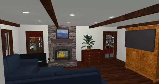

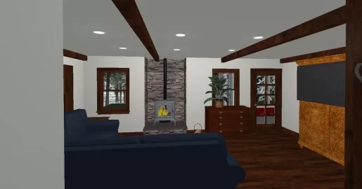

Jharkin, the farmhouse is 1946--not as old as yours. We did put plastic storm windows up on some windows and that helps a lot. We have a few more windows to do. Will look into the weather stripping you suggest. We are planning to replace the single pane windows and improve the insulation. Since you say you love pictures, I'll include some--existing pellet stove, rendering of remodel with fireplace and wood stove as viewed from the proposed front door (where the existing pellet stove bump out is).

Nice "pictures" but what can we see there? Is that the same room with different options? Or does it show the pellet stove in the first one? I asked for it because I wanted to know how that was heating your home. If you are thinking now about a cat stove I would ask someone here how it does regarding flames. From what I have heard here there are less flames than in a secondary burn stove. Since you like to look at the fire that may be an issue for you.
The Jotul F3 CB is a nice, dependable stove but has a really small firebox at 1.1 cu ft. You will be hard pressed to get an overnight burn out of it. If the stove can be more functional than presentable in the studio there are certainly cheaper options around. The Englander NC-13 for example or the PE True North. Both can be had for under $1000. What kind of look do you prefer? I am sure we can give you some options to compare.
I'm no expert, I don't even have a stove yet. Just ordered the Woodstock Progress Hybrid, to replace my fireplace, one of the many reasons why is for the exact reason you stated, the ambiance of a fire. After a bunch of research and searching, I found the Progress seems to have one of the nicest fire displays, while also being an efficient heating device. Search Youtube and this site for "Progress Hybrid", there are some great video's of it burning. The point is, I'd loose the fireplace, and install a stove! ;)
