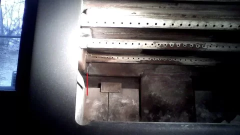

I would recommend checking the secondary air manifold in the corners for cracks, where the red line is in the picture. My liberty developed a hairline crack from expansion and contraction not being overfired but doesn't effect it at all. $700 sounds a little on the high side for a 7 year old stove but if its in perfect condition, considering what they cost new I would not pass it up

Great information. I wouldn't have thought to look in there at the welds. It sounds like this isn't a great deal, so I'll keep an open mind and see if he is willing to deal. Kinda weird haggling with a neighbor, but I'll give it a try.

I think if the stove and the secondary air tubes are in good shape, $700. is a reasonable price, but I would offer lower to start. I've burned my Liberty for 10 years as my only souce of heat in a 2000 sq ft house and I've never had to replace them. I do have a small crack in the upper inner corner weld like described above but it has never caused any problems. Lopi was offering to fix these under warranty for a time but only to the original owner.

No, I haven't had to replace anything. I've burned it very hot at times, too. I'm actually surprised I haven't had to replace the secondary air tubes because I sold Lopi's for years and we'd get customers in buying those on a regualr basis.
Well I dug into it and the air tubes are solid, no cracks anywhere. The blower with thermostat came with it and one fire brick was broke. The outside looked really good. I went ahead and bought it and I think it is going to be perfect for my cabin. Hey Jeff, the new place is up by Hubbard Lake.
