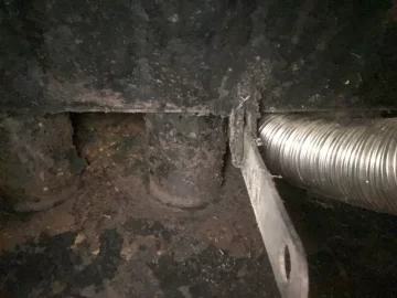

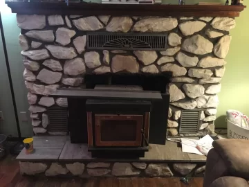

I’m pulling out my pellet stove insert and going to buy a wood stove insert. However, my fireplace has three blower pipes that will keep keep me from putting pipes for the insert in. What are my options?
Is this a prefab Zero Clearance fireplace or is it more of a heatform (heatilator) style fireplace with a masonry chimney? Pictures are welcome.
The pipe that you see in this pic is from the pellet stove that we are removing. Approx 3” in diameter.

Looks like a heatform style fireplace. The middle tube will need to be cut out.
The insert will be much more efficient and will not suck air and warmth out of the room the way a fireplace will as it is cooling down. However, once that tube is cut the fireplace will be unusable as a fireplace unless that tube is welded shut with a cover plate.

A couple more questions. With in those pictures, you can see that the current pipe for the pellet stove has to curve around this steel barrier for the fireplace blowers. Does all that have to come out? Also, somebody told me that piping has to go all the way to the top of the fireplace. Is that true?
You need to cut out enough to fit a flexible 6" liner down through that area. All of them that I have done have enough room without cutting any more than a tube or 2. But yours may be different. I also rivet sheet metal over the holes left by the cut tube to stop airflow.
And yes the liner needs to go all the way up.
