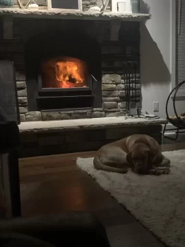

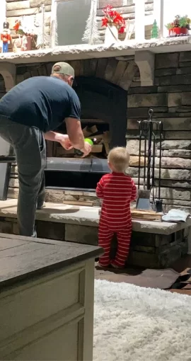

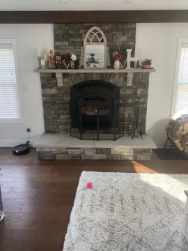

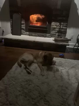

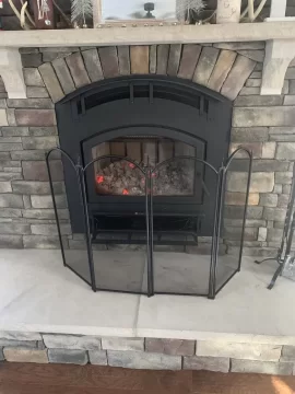

Hello. I had a pioneer iii installed in my addition . My home is currently 2500 sq Ft colonial. The stove is in a 22.5’ x 19’ room with a 14’ opening into other Rooms. They kinda talked me into the larger one but I can with ease get the room to 85 degrees and keep the rest of my house at 68-70. With out reloading the stove some bedrooms get down to 64 ish and the coldest about 60. I do love this thing although I could probably burn more efficiently with a pioneer ii. The house stays warm well after the fire is out. My question is that I’ve burned about 3/4 of a rikk in about 8 days . I’ve been packing it at night choking it down and I know that’s not good to do in regards to creasote deposits and I’m getting deposits on the glass . Last night I didn’t choke it and woke up to nicely burning coals and clean glass. I also haven’t been able to fully use it to its capacity because first fire the circuit breaker was fried. The tech called quadrafire and supposedly this was the first of this ever happening to this model. 2 weeks later they installed a new circuit board and instantly popped the breaker and fried that one… 3rd is in order. My SBT button works, manually adjusts the flu in stages , fan works , but the light on the button is non existent and there is no communication with the thermostat. I’m frustrated to say the least. Oh I also have 1 heat zone kit installed in our master that’s above the room the fire place is in so it really doesn’t need to be turned on. Just looking for tips . Running humidifiers all over my house to to try to keep it around 38-40% . I really love burning wood . But this is much different than my ol manual pot belly stove in my msn cage. If any has and words of wisdom I would greatly appreciate it . John from Ohio
