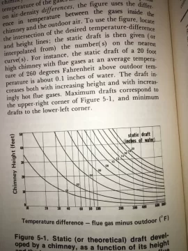

You will be OK with that chimney height with enough differential temperature between inside and outside of chimney. As an example, using chimney height table with temp difference; .04 (inches of water static draft) requires about 140* temp difference at 13 feet. A 20 foot chimney gives you .04 at only 80* difference. I'll try a pic of a table so you can see what to expect. You can see how it would be an issue if you were farther south without cold enough temps.
