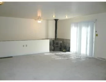

My girlfriend and I are seriously considering buying a house that has 2 wood burner stoves, one in the living room and one in the master bedroom, both are small and neither of us know anything about them. The house has been renovated within the last 3-5 years, both units are new from the remodel and haven't been used in the past 2-3 years due to the house being empty. The unit downstairs plugs into the wall, I would assume from some of the research that it has a blower attachment on it, the upstairs unit does not. The pic I am including is from the realitor's website, the unit shown is the master bedroom and is simliar if not the same as the one downstairs. My questions are as follows:

Something that would help would be to find out the make and model of the wood stoves and see if you can get a copy of the user manuals online. Very good chance that you can if the stoves are new. One part of the stoves being installed properly is to measure the distance from the stove to all combustible surfaces (sheet rock or plaster walls, wood, etc.) The manual will tell you distance from front, back, etc. This is extremely important for safety. If any surface is not that distance or greater, operating the stove could result in a fire. The manual will also give you lots of handy info like how to properly operate the stove, etc.

definitely get a chimney sweep to look at the chimneys to make sure the chimney is clean and they will help do a test fire to make sure it is drafting well. From the picture cannot tell if there is non combustible materials on walls and floor. IF it is far enough from the walls and ceiling you do not need special materials but the floor has to have non combustible material about 16 mor more inches in front of the stove. The heat from them is GREAT, just ask all your questions and you will love you have these in your house. Get the manual just google the model etc and you can find that on the back of the stove usually on a label and get the manual and go over it many times.

Agree with everything above. The stoves appear to be either Englander 18-TR or 18-MH stoves. If they are, manuals with installation and clearance information are available on England's Stove Works' website.

In the Pic. It looks like the clearances are good and there is plenty of hearth in front of the stove. The short wall on the left looks like it is an open stairway with the top being to the left of the pic.
Well, it's considered a "master bedroom". It's a whole addition to the house, someone added a 2 car garage and that bedroom and stove is above it as well as the washer/dryer room and a bathroom. The dementions are 24x29. You are correct that there is a starwell leading to the first floor to the left of the stove as well as sliding doors heading to a small deck on the right. To my knowledge this room has been used as the bedroom as the previous bedoorm downstairs was converted to a coumpter room of somesort.
