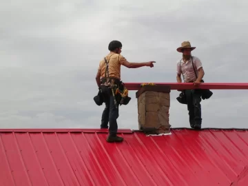

Husband seems to think it's pretty much okay, but I'm pretty sure it doesn't stand tall enough above the roof - doesn't look like 3' to me from the ground (and it's a slippery tin roof - not going up there to measure, though some brave soul might). Have to get it actually looked at by someone who knows more. We're learning this whole deal by baby steps.
I'm assuming you have a single level home (like a ranch style). Does your chimney have the 10'/2' requirements coming out of the roof? also, if the chimney is fairly short you have draft issues to consider when the project gets moving along, the short flue runs have weaker drafts generally. Also, if the chimney is in decent shape maybe you would consider your amish neighbors to to extend the flue and do some exterior pointing while they are up there.

The chimney is NOT in great shape. I knew it had been covered in cement at some point, but after checking, the brick underneath is crap, at least the part above the house. For what it's worth, I can post a pic tomorrow. It is at the peak of the house, so no problem there, and it is more than 2' higher than the roof line, but it's looking more like replacement since the brick is in such bad shape. It is, indeed a one-story house with an attic (more for the chimney to go through when it's replaced... sigh). I'm guessing 16 to 17 feet top to bottom. The inside is covered with wallboard, so not really ready to tear that down since it's no doubt going to be spring before anything happens with it. Thus no pics of the chimney inside yet.

Here are a couple of pictures of the chimney in question. The pics are about 4 years old, so certainly nothing has improved. In the pic with both chimneys showing, the one in question is on the right. Too bad, eh. The other looks a lot better.[Hearth.com] Newbie with stove-hunting question - Got the Englander [Hearth.com] Newbie with stove-hunting question - Got the Englander

Kam, I have to agree with you on the chimneys, the one on the left may have some life left in but still hard to tell from the distance the pic was taken. At the least it could be repointed in the exposed areas. Also, considering you have just one story, replacement could have been worse for the chinmey you plan on using. You could have had a full basement and 1.5 more stories to think about. You may want to consider running class A up and out and doing away with the chimney all together.
