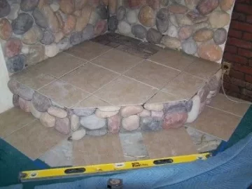

3. should I leave an "overhang" of the flagstone to accommodate the manufactured stone underneath?

Not sure if you're going for something like this only with flagstone (we used tile), but they did the stone first on the walls and the face of the hearth--then layed the tile. There is a slight overhang, but not much. Picture below.
