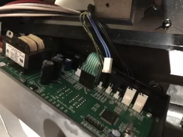

Did a little more digging and found a few potential items.

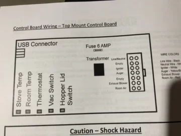

Took the top control panel apart. Not sure if I dislodged it or it was this way, but the wires for the vac switch were disconnected. Also, the connection for the thermostat is just a jumper, there are no lead wires coming out of it. Is this normal?

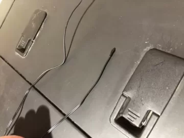

Lastly, the room temp sensor wire was bundled up and stuffed into the back of the stove behind the panel…

Might be worth a try. The room probe is so you can move it out a bit away from stove.The T-stat jumper needs to be there, The one all the way to the right- "stove", might unplug and make sure terminals are ok,and follow wires into stove and see if the other end if it looks OK.
