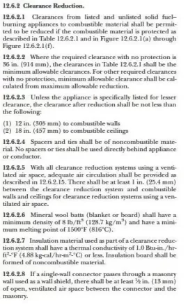

There is an exception. Here are the relevant paragraphs. Look at sections 12.6.2.2 and 12.6.2.3.
Do you have the excerpt from 12.6.2.15? It is in reference to air space around/behind the wall protectors. I'd like to know if the wall protector only needs air space top and bottom or also on the sides.
Both need a minimum 1" gap for ventilation. Single flat wall shield can be 1" at the sides and top or at the bottom and top. Corner shield 1" gap is at the top and bottom.
Whoa, I was seriously stressing out when I read JoeCool's pasted code about the 12" minimum. I guess 12.6.2.2 provides the exception I need to reduce my rear clearance from 13" to the 6" I actually have as installed. The inspector told me my math was okay, and my insurance company will cover the stove with a copy of the permit. Still, I will print out both of those charts today to explain why the reduced clearance below 12" is allowed.
Hmm, looked right past this. Due to section 12.6.2.2 I suppose I could get my Amesti down from 14" rear to 4.67" and the sides from 16" down to 5.33". I will have to think about this. Our living room is small enough I was planning on using wall protection just to go down from 14" to 12" and 16" to 12". Of course, I would assume that even if the stove ends up with an ok wall clearance of 5", you'd still need the minimum 8" on sides and rear for ember and floor protection right?

BeGreen said:
Following up on Rick's good reminder, does the Amesti manual approve clearance reduction using an NFPA211 wall shield?
Yes it does. And if I had paid more attention to the manual than to the code book I would have noticed it says right in the manual that using wall shields brings the clearance down 66%.
