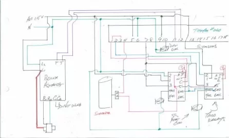

The granite group has a special designed Buderus system with American controls that are the most reliable and not too expensive that any oil man can fix but may never need to!! We both went with separate circulators instead of zone valves which is also better for more efficient DHW so keep that in mind also!!

See Buderus Wire Diagram Below:
