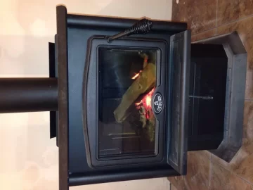

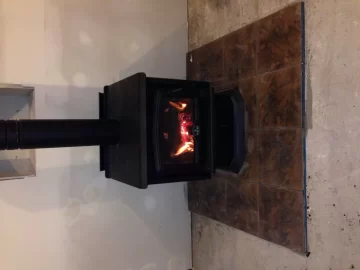

[Hearth.com] No Draft My fire at 10 minutes and at 20 minutes. It's pretty well out

Wow! Quick responses! Ok, we called the pro, he told us to open a basement window. There was no improvement. My wife and I then went upstairs to argue about it. When I went back downstairs my drywaller said he opened the basement door and the fire picked up! Would an open upstairs window contribute to stack effect? This morning the outdoor temp was 12c.
yes an upstairs window ope can contribute to stack effect, as can draft fan vents and anything else that leaks air out of the upstairs.
Install the OAK and you should be fine.
first, be sure the negative pressure downstairs is the problem.
if opening the downstairs door makes the unit draft right everytime, then find and reduce the leakage upstairs
if that doesn't correct the problem you could install:
(broken link removed to http://www.humidex.ca/products/air-supply-ventilator-asv-90/)
Yes, opening an upstairs window will create negative pressure in the floor below. It sounds like the stove may benefit from hooking up an outside air kit. (OAK) In the short term, open a basement window a little bit and be sure all upstairs windows are closed and there are no exhaust fans running. If the stove is still breaking in the paint, open the basement door too and send the wife out on a long errand. It will be stinky until the stove has a chance to bake the paint which will require getting it up to about 500F on the stove top. She will probably not appreciate the temporary smell. It goes away completely after a few good fires.
Your stove is really going to want to burn only fully seasoned wood. Do you have a good supply that has been stacked and seasoning for at least a year? (Two years for oak.)
