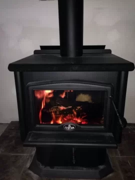

  • [Hearth.com] No Draft

What wood did you burn in the pic above? Because for the air fully open that looks pretty abysmal. It is even weirder that you seem to get some secondaries. Maybe it's the stove but mine would have no secondaries at that stage with the air fully open. How does the wood burn with the door open? Do you see a lot of smoke; are the pieces "hissing"? Have you started a fire and after approx. 15 min with the door still open taken a look outside at your chimney whether smoke is coming out of it? (Have your wife stay with the stove.)

Grisu, at that point I believe there was a 10" 2"x4", 2 10" 1"x 3"s and a 4" maple split. The softwood was dry. The maple was in front of my dehumidifier for five days. The draft was wide open. There was smoke coming out of the chimney. The door could be cracked with no smoke spillage. But even opening very slowly from there would allow a lot of smoke to escape. Out of curiosity could it be the cap?
