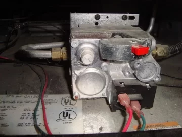

I have a nat. gas Heatilator GC 300E fireplace. When switched on the igniter sparks but no flame although a week or so ago it did work sometimes. It has a Robershaw Gas Valve NG (71516). There is a current to the valve when the igniter operates. There is no gas smell. Could the valve be defective and how can one test it?

It may not be the valve. Can you post a picture of what the valve looks like?

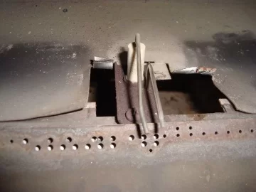

Can you also post a pic of the pilot assembly?
Hope these work for you.

Wow. Old stuff there. Somebody else may hafta chime in on this one.
Those older DSI units were troublesome. The only time I worked on them was to change them over to a standing pilots.
That might be the better option than simply replacing the outdated one.
