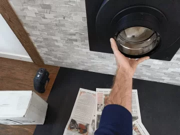

Here is a pic of my Thimble connector... this part and the DVL stove collar adapter put me at 9.3 inches to combustibles. A pretty close to the wall install, but approved by manual and given the okay by jotul tech support. Just not enough flue pipe to use any sort of probe thermometer.

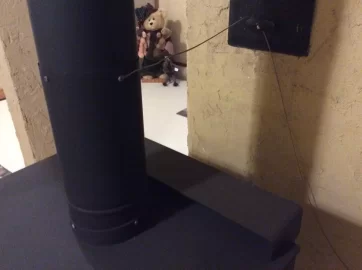

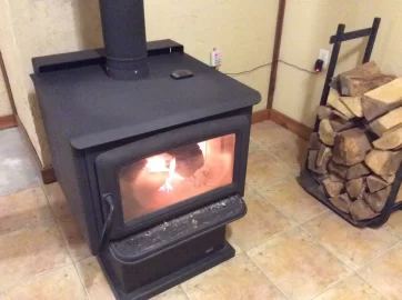

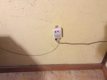

Many people are resistant t thermometers but myself I find them invaluable. I run an auberin at210 with a ring thermocouple affixed to single wall connecting pipe on my downstairs stove as well as various magnetic thermometers for stovetop and a IR gun too for checking/confirming things. With double wall pipe you are limited to a probe and myself I'd be getting a probe of some type in that section to monitor exhaust gases. If the proximity of the probe to the stove is considered to close because of the faces of the probe thermometers I'd look to using a probe thermocouple on a auberin unit or something similar were the 'readout' could be a safe distance away from overheating.
A lot of people don't/wouldn't like the look of the digital auberin readout, my wife doesn't. But for me this is a basement stove and another benefit is it wirelessly will transmit to a remote readout upstairs. Extremely convenient to keep an eye on things on another floor. But I had to fight like crazy to get 'permission' for the readout upstairs which is where we are for the most part.

I know hindsight is 20/20 but why did you put your thimble so low? Even with a rear exhaust stove you could have elbowed up and out. Now you're kinda stuck if you ever change stoves for some reason.
