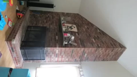

I have a beautiful very large raised brick fire place, I will upload a picture soon.

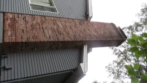

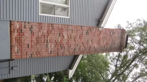

Take also a picture up the flue to see what kind of chimney/damper you have. When was the chimney cleaned?

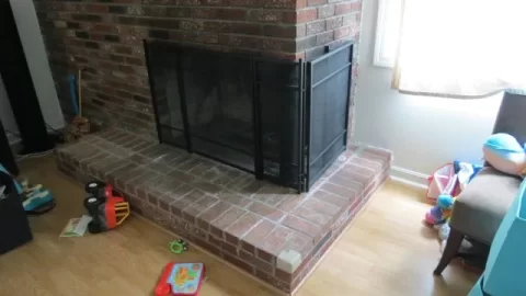

As promised here is my pictures... sorry about the mess ;). I also have a few pictures of my chimney... it is LONG!.

My limiting factor will be the 28" hight... and that is the complete hight of my fireplace opening, also no side doors.

You would need to place the Progress in front of the fireplace on the brick hearth. Your hearth may be deep enough for that but you will need to place a hearth extension on the floor in front of the stove. Side-loading should not be an issue then. (Given that your fireplace is open from two sides may not be one even when you could recess it completely in the fireplace.)

Your chimney probably isn't lined and you don't seem like your going to have it done.

This looks like it may be a better set up for an insert instead of a freestanding stove. That will provide more options. Regardless a full 6" liner will need to be put in the chimney. Do you know what size the current tile in the chimney is?

An insert really may be the best option here. You won't see anything but the stove side anyway. The insert does not have to have the surround installed if you want a more open look. It sounds like this is essentially what you are thinking about with the Buck 80, which is a good choice.

My chimney is not lined... but of couse I plan to have it done!!! I figure a new liner suited to the stove would solve my issues regarding draft.
