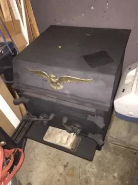

Hey all, can anyone help me identify this stove? It's posted on my local craigslist and I wanted to do some research before buying.
  • [Hearth.com] Non-EPA Old smoker vs New EPA stove decision
I figured it out, it's a bullard double door stove. Now to figure out what to buy. Oldschool non-epa stove or a newer summer's heat wood stove. http://www.lowes.com/ProductDisplay...atalogId=10051&productId=999918844&cId=detail
I'm able to get the old one for 350 and it's stated to heat 3,000 sqft but I'm worried about the wood consumption and overall safety of the older units vs the newer ones. Also, the old one doesn't have a blower whereas the new one does.
Lastly, the old one has an 8" exhaust and I have a 6" chimney.
Anyone want to chime in to make this an easier decision on me. I'm lost and can't get a hold of any of my local installers to weigh in for me.
