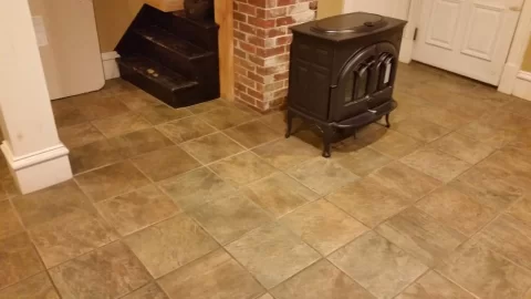

I searched the forums for this, but I couldn't find an answer for my specific question. I recently purchased a Jotul F 600 which only requires ember protection for floor protection. The flooring in the location of the wood stove is a tile floor with grout that has minimal cracks. Now, for additional safety, I plan to put the wood stove on 48" x 48" hearth pad. Now, the hearth pad is not the correct size per the Jotul requirements, but it will extend about 18" past the side loading door and a few inches in front of the stove (I don't plan to load from the front). My questions are:
1. Technically, as my flooring is "non-combustible", could I put the wood stove on the tile floor with no hearth pad?
2. I've attached a PDF of how I want to position the hearth pad relative to the wood stove. Any comments or suggestions?
I've also included a picture of the flooring where the wood stove will be located. (Note: The location of the wood stove in the picture is not where it will be located)

1. Yes.
2. Since you don't need a hearth pad it is up to you how you position the stove on it but I am not sure if your draft will be ok with those bends. Think about putting 45 elbows in instead of a 90. Will the chimney be lined?
I agree with GRisu. Tile floor is non combustible, so it meets the requirement. I have a Lopi stove that has a similar requirement - the flood must be non-combustible but that is all that it required - and the floor never even gets warm under my stove. I wouldn't worry about a hearth pad except as an extra protection against embers and scratches if you have nice tile.
