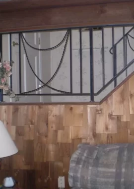

My famly room is finished in the basement and this is how I get the heat upstairs. Its a split .
  • [Hearth.com] Noob Here: Who has a pellet in their basement to heat the upstairs?
