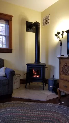

This year we finally got a stove after wanting one for more than a decade! We went for the Craftsbury model by Hearthstone. So far we have about 2 weeks of sporadic burns in, and we love it a lot. Seems like a super quality stove. With the blower our stove was approaching $4,000. Our house is also about 1,400 sq ft, and for that size it seems just right. 20221026_174451.jpg

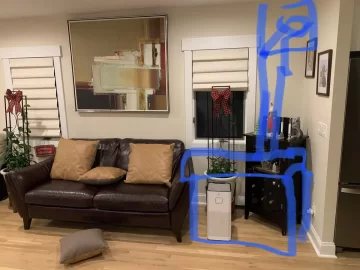

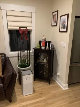

This year we finally got a stove after wanting one for more than a decade! We went for the Craftsbury model by Hearthstone. So far we have about 2 weeks of sporadic burns in, and we love it a lot. Seems like a super quality stove. With the blower our stove was approaching $4,000. Our house is also about 1,400 sq ft, and for that size it seems just right. View attachment 301886
Do you think I could have a similar set up on the corner - where this little cabinet is and have the double pipe exit next to window?? With a craftsbury?? Pardon my bad drawing haha
View attachment 305067 View attachment 305068
Sure. Why not get a WETT certified installer in there to tell you what you can do. Pics and drawings for an online site may not give you all the info you need. A steel stove will fit right in there I bet.
Right on, thanks for the reply. I definitely wanted it done safely and proper.
