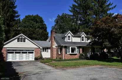

Hi. I’m not sure what you mean by clearances, sorry. The chimney is a stainless liner up through an existing brick fireplace. It is on the outside wall. It is straight down but they needed an offset to attach the liner to the top of the insert. It was done by a professional installer/sweep. I’ve attached a photo of the exterior of the house. Ok good on the smell from outside. I just wasn’t sure. We do have carbon monoxide detectors but still a little nerve wracking as we have not done this before. My only fire experience is with a fire pit in the back yard.

Nice house! Im thinking you could probably close the window. If it burns well it isnt needed.
