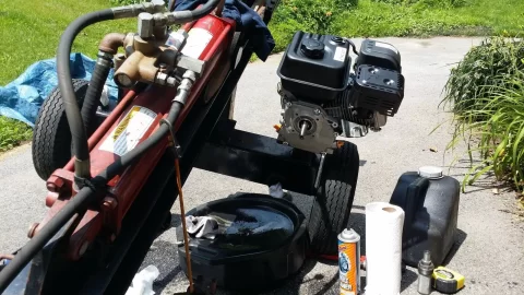

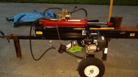

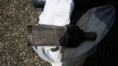

Woops double pics. Anyway you can see what i did to drain it. Sprayed brake cleaner in the fill hole to drain down. Put a sock in to soak up the corner. Mesh filter all clean and looking fine.
Well splitter all set cleaned up nice. Glad I changed the hydraulic fluid it was contaminated. Broke in the motor properly and it is working great! By the way I hooked up the pump lol.
