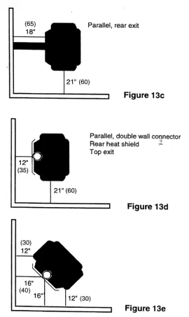

The basic situation is a Jotul 12 Firelight in my customers living room that currently sits 5" off the walls in the corners where it calls for a minimum of 12", the single wall pipe is 14" off the wall, and they have 9" of ember protection out front.
We're going to be replacing their carpets with hardwood and they're not happy with their old brick hearth pad. So they asked about a pre-fab one, biggest they could fit there in the corner given a sliding glass door, same size as the brick essentially.
Now that I found out that their stove that's been there for 25 years is why out of spec and can't be made right given the location, can I touch it without being responsible for anything that'll happen down the road?
Essentially they just want it moved, flooring run under it, hearth pad (same foot print as what they have now) put down, and stove set back where it is. It's just that where it is isn't right. I know all states are different, wondering if anyone has any input on the liability factors at play here.
