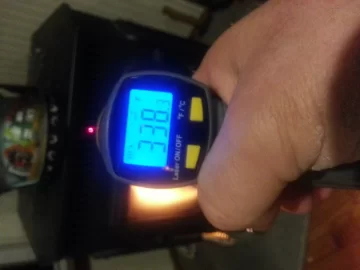

I have been runnimg my CPM for 4 seasons now as a primary heat source, I have yet to use a secondary heat source. My stove temps have been taken with an IR gun. The burn pot can, on cold high burn days, reach 650 degrees. The ir temp at the blower vent is always 350 degrees plus. 4 years now with my cpm. Wouldn't trade it in at all. As with any stove, air to fuel ratio and clean intake and exhaust.

ok thanks...what 3 button settings and what feed/blower setting are you running to get the 338?
