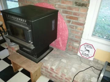

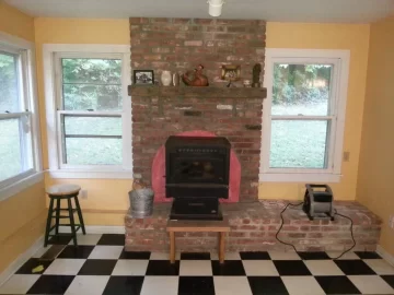

Here is picture 1 and 2 of the pellet stove contraption (this is at the end of the living room). Not a pellet stove insert - old owner tried to make it one though :/
[Hearth.com] Not sure if I'm in the right forum...need stove placement advice [Hearth.com] Not sure if I'm in the right forum...need stove placement advice
Ok, this is not as crazy as it sounded. The stove solution shown makes sense. It sounds like the main issue for the present is to determine the viability of using the existing equipment (or not) for this year. The fact that the LR and back area is less used makes it a good candidate for the pellet stove, particularly if that stove has a thermostat and can keep that area at say 60F while the front of the house is kept at a more comfortable temp by the wood stove. Heat from the family room can be persuaded to circulate by putting a simple table fan on the floor in the large opening from the dining room to the family room. Point the fan so that it is blowing cooler air from the DR into the stove room and run it on low speed.That grey fan would also work just fine.
The most important thing now is to examine the condition of the equipment and their respective flue systems for safety and operability. So far this is looking less scary than I thought it would be. The pellet stove could either have a same height brick extension built that matches the current brick (it doesn't have to be the full hearth width). Or the hearth lowered by removing the brick. (not all that hard).
View from pellet stove toward kitchen
*disclaimer: please ignore all the ugly floors, wall colors and half painted rooms with tools everywhere. We are halfway moved in and scrambling to figure out how to heat the house by winter

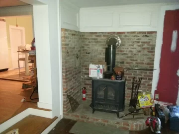

view of unused wood stove in family room - currently acting as storage spot for tools and other items :)

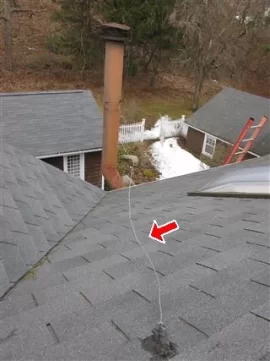

So far things look pretty good. Can you post a picture of the outdoor wood stove chimney? Not perfect, but better than expected.

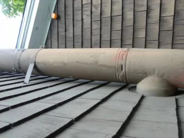

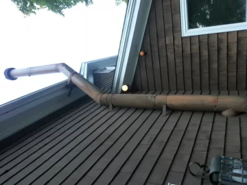

Last pics - the Harry Potter-like stove pipe (and the reason we were considering moving the pellet stove to where the wood stove is located...cheaper pipe install (Wood stove pipe install quoted at $2300)

It's hard to tell if the pipe is rusted or if they sprayed it with the shingle stain/paint. Looks like painted galvalume. For sure it needs a proper roof brace. But that is not a big deal. Have you had a certified chimney sweep check it for safety? It might just need the upper sections and cap replaced if they are all that is rusting.

It may have been sprayed - I'll go look again. I know certain parts are definitately rusted. Also - the 2nd chimney guy said it was an indoor pipe. I wasn't there but my husband said you could see it right on the pipe. I"m going to go look and double check with him I have the story straight. I wish I was there to talk w/ chimney guy the other day - it's alwasy hard hearing the summary vs all the details! I just remember the end result was it was rusted and old and not a pipe meant for outdoors. Oh...and it is really close to the side of the house
Ok. I went out and climbed up to look. Will need to get the bigger ladder to go higher to check out the rust up above - but from what I can see, you are right about it being painted. That makes sense since he probably wanted it to fit in with the old look of the house. One of the pipes said "amerivent 6B" on one of the pipes. Hard to tell. Up higher, it looks rusted, so I'll go check that part out. It's definitely dinged in a few spots. The man who looked at the chimneys is a certified chimney sweep, part of the national chimney sweep guild and CSIA. I can't see anything that shows this as an "indoor pipe". I'll get in touch with my husband and find out more info. I think I mentioned this already but the pipe is close to the house - it says on the pipe miniumum of 2". I think it's 1.5 in some places. Again, I'll check.
I think what you need to do it decide whether you want to heat with wood or not first. It is more work and a little more messy, so not for everyone. And you need a place to store stacks of wood. Some yards are not large enough for this. That said it is hard to replace that deep bone warming heat and the beauty of a nice fire. It is also a fall back if your area has frequent or long power outages. A pellet stove will provide nice body warmth if you stand in front of it, but the fire is not that appealing. It is essentially a small furnace and like furnaces they are noisy. Do you want that in the family room? There are newer pellet stoves that are quieter if pellet burning is more appealing to you so you might consider getting a second pellet stove for the family room if burning pellets is more appealing to you and if it make economic sense.
Personally I don't like the current wood stove location. It is too shallow for required hearth depth, though that could be extended. An ideal location from a heating standpoint would be directly opposite of the opening to the dining room. That way the blower on the stove could direct its output toward the other rooms. But this is easy with other people's money. Ask yourselves key questions. Do you want to heat with wood, or just pellets or both? Is the current location of the family stove the best? Could the living room be much more appealing if that is where you could have a nice cozy fire in a wood insert?

Here are two more from the pipe. Husband said the chimney inspector said pipe is the type you run inside your house, not stainless steel. So you are probably right it's galv.alum.

Unfortunately, we can't put the stove across from the dining room doorway - there are two big windows there. *sigh*. Not an easy fix.
One last question, before I stop bothering you for the day. what doy ou mean by the current stove is too shallow for the required hearth depth. I think I get it, but just want to make sure.
