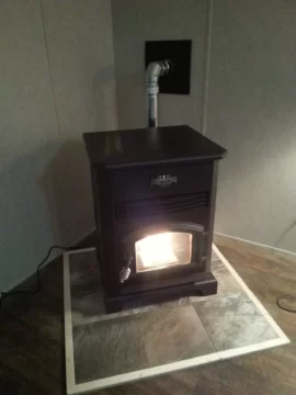

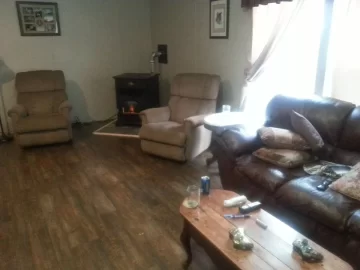

'Nother stove & placement thread, sorry :P

    Cool, when you gonna fire that sucker up anyway ? !

    'bout 8:00 last night lol. Had to run to town to get some pellets. So left it on 3 for a while as the manual says for first burn. Tstat on the wall said 75 in probably an hour (first time I looked at it). Left on 1 overnight and still says 75! Obviously the br's are cooler, but it's the same (our maybe even a little better) than when we were running the furnace ==c Although I'm still having a hard time with the fact that I have a fire in a box in my brand new house. Kinda freaking me out a bit lol. It'll be fine after I'm used to it I'm sure, it's just getting there.

    Well the key to that concern is "the fire is in the box" ( I never got the concept of an open fire in a fireplace by comparison). My wife and I have had stoves starting with gas ranges, then wood stoves and coal for 45+ years, so the pellet fire was just more of the same to us. We like the glow in the living room with the lights turned down low actually.
    So congratulations on a good and successful install ! FWIW, the main part of our house is 73-75 deg 24/7 LOL.
    ( if you don't have that stove on a surge protector, do it as soon as possible, it has an expensive board in it that needs surge protection)

    True, as long as its in the box we're good lol. And its on a 2100J (I think it was) protector already. Rather fry $20 than however much that board is :eek: Wife just refilled the pellets around 2pm so seems like we're doing well so far. I can definitely see how the glow would be nice!

    Hey that's the vac I was going to get anyhoo ==c Glad to hear good about it. Yes we're on full day #2 now and I'm a lot more comfortable. Also eased by the fact that the main room is dern near 80::F bahahahha >>
    Yep glass is black. Think tomorrow is going to be shut down & clean glass day. Then I'll bump up the draft fan. Everything is on auto right now.
    I super appreciate everyone here and their input;ex You guys are awesome for us noobs ;lol

    80 isn't really the intent that's why it's been sitting on #1 heat range lol. I'm shutting it down now. Can't really see the flame anymore which makes troubleshooting difficult to say the least :p
    After a good glass cleaning and burnpot dump (since I'm in there) I'll play with the settings. I did read an old post about adjusting feed rates for the great settings tho not sure I want to try that just yet.
