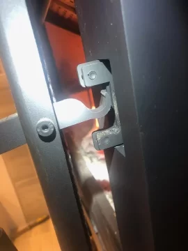

2. Door latch sticking..... This is huge safety hazard. Once the stove is heated to operating temp, the door requires brut strength to open it. There is an adjustment for the latching of the door, but this is not the issue. I'm able to latch and unlatch, but the door will still not open. This is due to the latch rubbing up against the adjustable plate (once the stove is warm and metals have expanded). The latch will require removal and grinding of material.

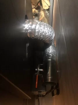

6. Fresh air kit ......... The fresh air kit is essentially 4ft of dryer hose for $100. And it doesn't even fit around or in the adapter plate. They claim you sort of thread it on around the outside, but it doesn't work. It tears the material. Best thing to do is to use high temp tape, butt the two together and tape around the circumference. I would add a 3" damper while you're there. This way in case you have a run away fire you can smother it (and also control your air flow if you'd like).

Latch Issue:
Added damper:

Latch Issue:
Added damper:
