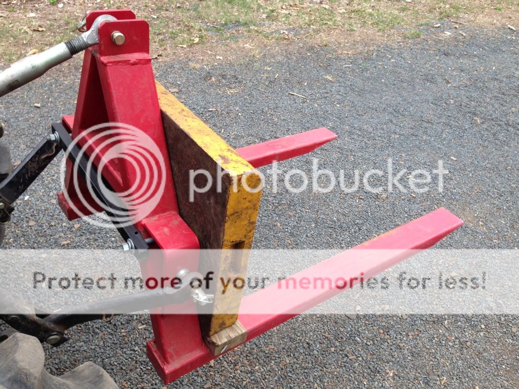

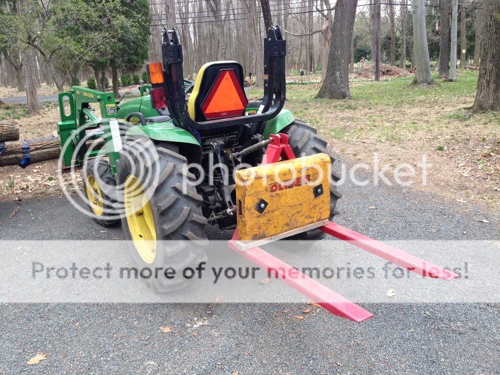

Added some ballast to the new JD 4310... it is one of two suitcase weights I have from my old Oliver OC-46 crawler tractor. Each one is around 26" x 18" x 4" thick and weighs 400 lbs! It's thin enough I can still use the 3 point pallet forks, which I keep on all the time because they are so useful... can't lift as high as the front forks, but they are way more stable moving pallets of stuff around.

Good setup. I use the barbell I am too old and scrawny to lift anymore in my quick hitch for ballast for the loader bucket.
I have a stack of those on the back of my Oliver loader.
Growing up I always used to see old time farmers with a huge block of concrete on back for weight . . . I assume they were home made. Do folks still go this route?
Yep - but around here it is usually a drum filled with cement and a rod stuck through it for the 3 point to hitch up to.
My ballast box is actually a steel box full of concrete. Works nice, as I sunk four 3" PVC tubes in it for carrying lawn tools. The advantage of the iron ballast is size, since iron has higher density than concrete.
