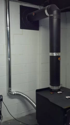

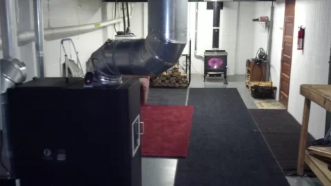

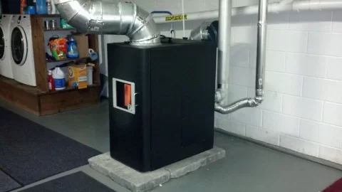

I did my Fahrenheit and my Wood eater in the last week (OAK'd).
I bought rigid 3" vent and then used 3" flex (found at ALL local Hardware stores)
Less than $40 for each one, including cap and tape (high temp foil)
I purchased 25ft of 3" aluminum flex tube from Chimmeny Liner Pro for $38.63. My neighbor did not have O.A.
for her pellet stove. Installed it down the chimmney along the 4" SS vent pipe.
I bought a 6 foot long piece of automotive flex exhaust pipe from VIP Auto Parts for around 20 bucks. It's the only place I found a long piece. It was 2" ID which fit over the OAK connection on my stove perfectly. I only need about 4 feet. I have a 20 foot straight rigid 4" flue so I have the inlet damper closed down pretty far because it drafts pretty good.
I used 3" rigid for the most part, then 3" flex. All found in the Dryer vent section of the hardware store. Then a 3"-2.5" reducer, and done.
I just did my Woodstove yesterday and did the same thing, except the woodstove has a 3" inlet, so a hose clamp finished it off.

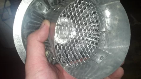

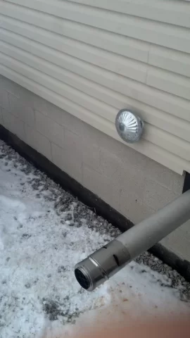

Was about $30 for each one. Including the cap outside, with gutter guard as a rodent screen. :)
